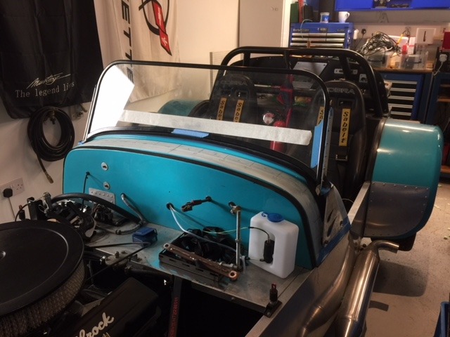

After much head scratching with the fitment of the uprights I decided to chop the ones I had an use them as a fixture to hold the screen in the right
place so that I could measure the actual profile and hole positions I needed:
  Screen fitted

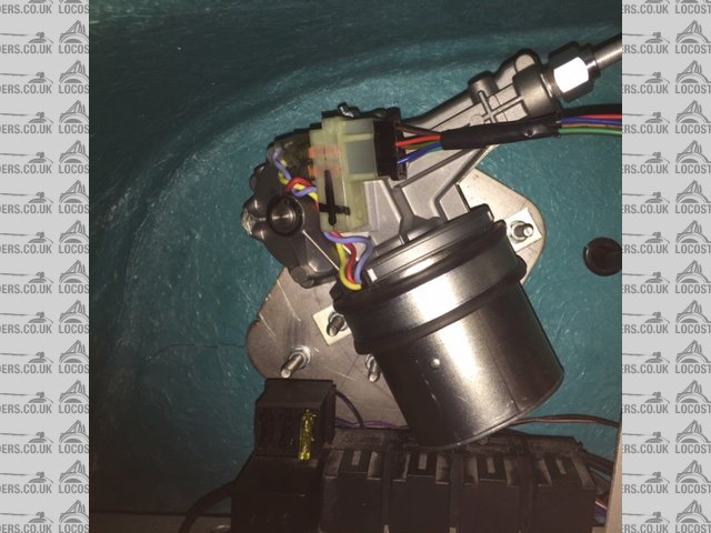

Wipers, wheel boxes and motor fitted (I had to use a 95 degree sweep):
  Wipers fitted
  Wiper box
I remade the battery box as I was never happy with the original one and also mounted the wiper bottle
  Screen wash

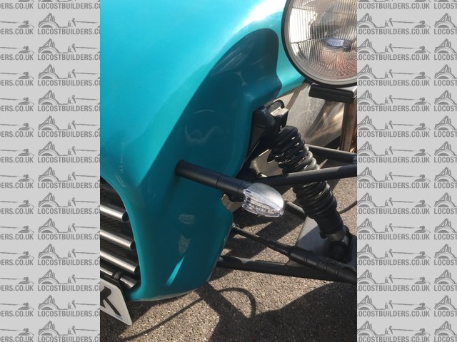

New front indicators and extensions:

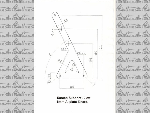

Windscreen Bracket Drg.
For anyone who fancies making their own windscreen brkts, here is a drawing _
  W_Screen_Brkt
This is a copy from a Caterthingy, S3 model.
Kev1n - Viento scuttle; is it same shape as MK? Caterthingy S3 screen fits OK on mine. But getting the auto quality glass was a pain. Screen is
designed to hold thinner glass than available now. Had mine cut from L/R Defender glass.
[Edited on 3/6/18 by Dick Axtell]
