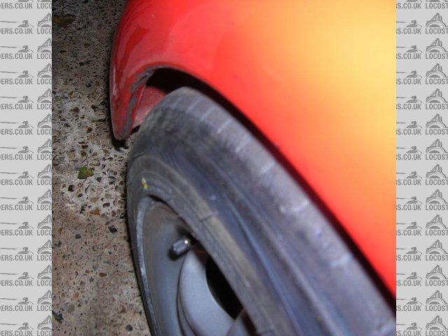

Hi,all.
Had the Velocity on a track for the first time today (at the RAF Marham Charity Track Day, big thanks to all the RAF personnel involved for a great
day in fantastic sunshine) Anyway all was well except we munched our way through a brand new Toyo on the rear offside with the rear wheel arch
fouling the shoulder of the tyre (it was basically an anticlockwise track with a couple of long, fast lefthanders which loaded up the offside wheels).
At the moment they are on 15 inch wheels with 195/50 tyres. After we noticed the damage to the tyre we managed to borrow a spare set of rears from
another (very kind) kit driver, these were 13 inch but still fouled in the same place but only very very slightly. As he was leaving about a hour
before the end of the day we took his wheels off and put our 15s back on, magically there was an extra 2 inches of clearance between arch and rim,
final blast out on track and the clearance had gone and the tyre was fouling again.
Any ideas why just jacking the car up would suddenly give this extra clearance and why did it disappear again, knackered shock perhaps and should we
look at the suspension or just change to smaller wheels (or both!)

a pic of where it is catching might help
norfolkluego
| posted on 18/4/09 at 08:05 PM |
Not sure how well these show up
| posted on 18/4/09 at 08:07 PM |
Suspect the reason you had the extra clearance after refitting your 15" wheels was because you had jacked the car up to change the wheels ,
after changing them you let the car down and thats when you had the extra clearance? As soon as the wheels had turned a couple of rotations the
suspension would have settled reducing the clearance? Could be that the wheels are too wide ,wrong offset, the rear ride height too low or the rear
wing fitted too low? Noticed at last years Newark show the lineup of Luego's had the rear wings fitted differently. Would it be possible to
trim the arches to gain extra clearance?

' wheels are too wide ,wrong offset, the rear ride height too low or the rear wing fitted too low'
I'm certainly worried we have the wrong size wheels (we didn't do the original build), most other seven type kits over there today seem to
run 13 inch wheels. Not sure which way to attack it, use smaller wheels or change the ride height, what I don't want to do is upset the
handling because that was fantastic (on the straights today we were murdered by the TVRs, Evos etc, through the twisty bits we were as quick as
anybody)

Thanks for the tip on the drum sizes, I'll have a measure up in the morning. When I had the tyres fitted yesterday I thought the looked a bit
buxom (same size as the ones I had taken off) the picture probably exaggerate it but they're really stretching the 'fully enclosed by
bodywork' definition.
Have to say the smaller tyres/wheels we borrowed seemed to handle everybit as good but on cheaper tyres which seemed to suggest that rolling radius
was right for the car, is there a magic formula for working this sort of stuff out?
| posted on 18/4/09 at 08:58 PM |
IIRC Luego did wide rear arches , it is possible to widen your existing arches.
norfolkluego
| posted on 18/4/09 at 09:14 PM |
'widen the wheel arches'
Sounds fiendishly simple (and cheap)

Had a good think about this and the handling is so sweet at the moment I don't want to do anything that might upset it so looks like widening
the arches it is. Has anyone done it on on Velocity. Is is a simple as fabricate some sort of (arch shaped) spacer, unbolt arch, fit spacer, rebolt
arch? Or is it me being simple and it's more complicated than that.

Had similar problem with my Velocity rear arches did not cover the wheels, Remove arch , place on piece of marine ply draw around arch , mark up bolt
holes , cut out with jig saw cover with colour coded gaffa tape, refit to car with longer bolts and wing piping and hey prestow jobs a gooden, i used
10mm ply by the way but work out what thickness you need by putting a staight edge accross the wheel and measure the distance between the tyre and
arch and add a couple of mm.
hope this helps worked for me otherwise it would of failed SVA. and there still on there now.
Regards Bill.
