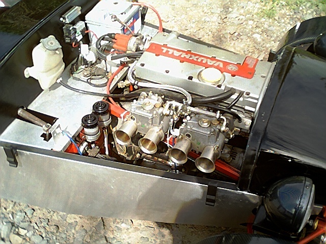

this is the power
heres the best engine for the kit
luego-lo-cost finished,vauxhall 16v 2.0,twin 45s de-dion rear set up

whoops
try this pic
andytmc
| posted on 13/5/04 at 07:51 PM |
Looks nice!
Hi Billy
Very tidy!
What other bits and pieces did you need to fit apart from the carbs?
