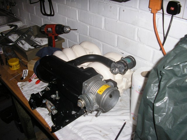

trial fit of manifold and throttle body.

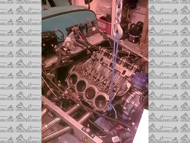

Paul (Notts)
| posted on 22/11/09 at 06:56 PM |
Head off and ready to fit new gasket. water leak was from the end channel outwards only so will use a little blue gasket sealent there.
still looks clean after 2 years
Paul

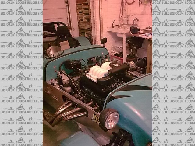

Paul (Notts)
| posted on 27/7/10 at 07:33 AM |
Almost ready for its first start up
just need to test the wiring for Megasuirt and pressure test the fuel system.
only problem is That I am off on Holiday now for two weeks.
Paul
http://www.locostbuilders.co.uk/photos.php?action=showphoto&photo=2lcb.jpg
[Edited on 27/7/10 by Paul (Notts)]
  almost done
