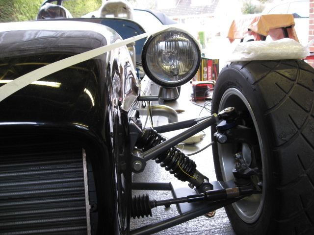

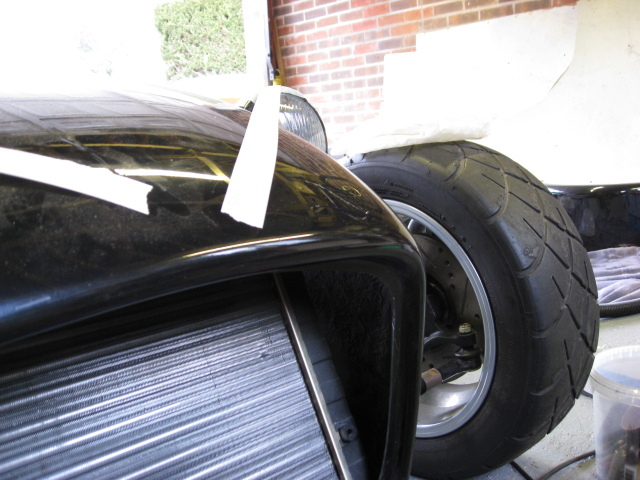

Some progress pictures... Plus a few challenges.....
Had a really good day in the garage this morning and up until about 2.00PM when I realised that where I have mounted the headlights I don't think
I will get 45 degrees @ 50% area. What do you think?
Is this visibility only on the horizontal or doe it have to be @ the -5 degrees also?
I also purchased some second hand westfield indicators thinking this would be a safe approach but they end up being further than 400 mm from the outer
edge of the rear wings.

| posted on 28/3/10 at 07:42 PM |
looks great apart from the headlamps being too far back.
don't see anyway to fix that without moving them forwards

Nash
| posted on 28/3/10 at 10:18 PM |
I think the lights will be too low (or too far back).
Nice tidy work though
