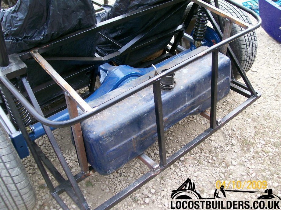

Daddylonglegs
posted on 1/4/10 at 01:06 PM Reply With Quote
Originally posted by norfolkluego
Boggle, back end of my Velocity doesn't look like that
No, but my +442 does:
(Extra bits are for fuel tank supports )
Danozeman
posted on 1/4/10 at 02:45 PM Reply With Quote
That the same as my live axle luego chassis except for them rear top tube supports. Mine are wider apart. virtually the same as the book.

There are differences in all 3 chassis backends pictured - your (OP) chassis looks most like the last lot (of pics)though...
wilkingj
posted on 1/4/10 at 09:09 PM Reply With Quote
Rear of a Luego has the seat belt mountings on the horizontal part of the Roll Bar. ie Seat belt mountings are directly in line with the holes in the seats and are an integral part of the bar.
Your chassis has them mounted on the top rail of the chassis, and is not a Luego Chassis (IMHO). See all 3 Luego Models below. All have the same seat belt fixing method for the top fixings.
Thanks to Piddy (for the pic)... its his car, but all Luegos are the same in this area.
Its a Luego Velocity:
This is Rusty's Luego Locost:
This is my Viento:
