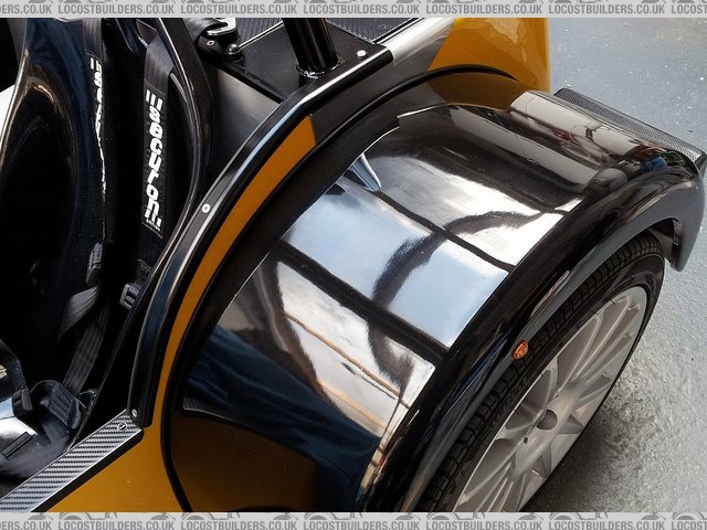

Side indicators will fail on the scuttle , ours did.
We were told by Mr IVA man to put them
in the rear arches (see borrowed pict)
  indicators
You may need resistors for these .
Good luck
René

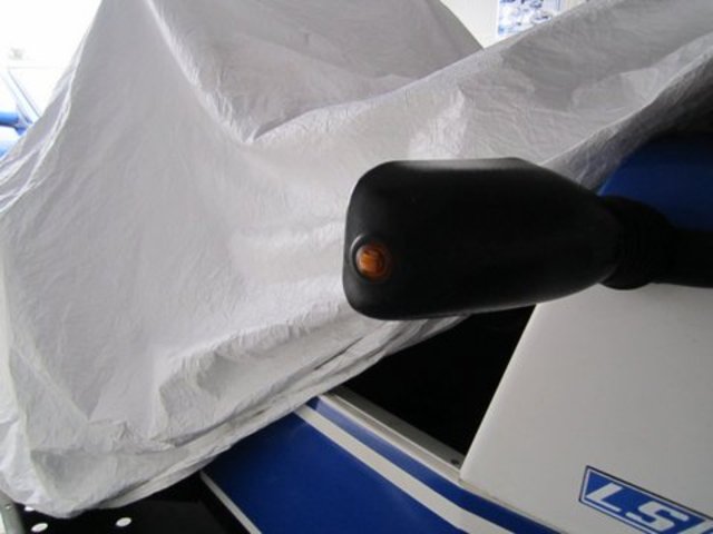

Jimfin
| posted on 8/5/13 at 10:42 AM |
Fitting them in the mirrors worked for me (on a locost) and passed the IVA.

| posted on 8/5/13 at 10:49 AM |
Much easier to put them on rear arches,already very close to wiring, and if you delete the rubber surround they look very neat (see my photo in
renetom's post )
I should say that you should check the distance from the front of the nosecone, 2.6metres maximum, very carefully.
Mine passed IVA yesterday with them

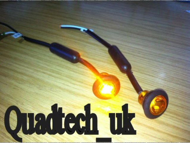

johnemms
| posted on 8/5/13 at 11:00 AM |
Easy pass in rear arch Nottingham
After IVA put an additional pair in the headlight bowls
  clear LED in headlight
