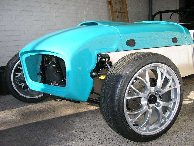

G3OFF
| posted on 2/3/06 at 05:46 PM |
2 much beer and a angle grinder...
..... always think it over first......
18" front and rear.... hard ride.. but as "emsfactory" say's "Might handle like a bag of shite but it will look good doing
it"
[Edited on 2/3/06 by G3OFF]
no such thing as to much power......
Tricky Dave
| posted on 2/3/06 at 11:02 PM |
Got to admit G3OFF, your car is SEXY!!!
