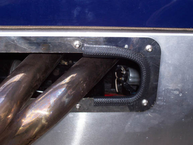

Also check other edges are radiused. I failed SVA on two external radiuses as they were contactable by the 190mm radius ball:
1- the underside of the headlamp bracket
2- the SS exhaust surround
I have stuck on the plastic coated metal u section on both areas. It looks soooo ugly, but guess what'll be the first thing coming off after it
passes !!!!

Donners90
| posted on 15/4/06 at 01:02 PM |
...and the exhaust surround
wilkingj
| posted on 15/4/06 at 01:19 PM |
I have been looking at that this morning. I was going to cut up some strips for the exhaust escrutcheon, and then fit them just before I drove in the
gate, as I recon they may melt and put black gooey shyte all over the stainless.
Good thing about the light mounts, how did you get it to stay on where the Tube is welded through or did you cut it down and glue it on.
