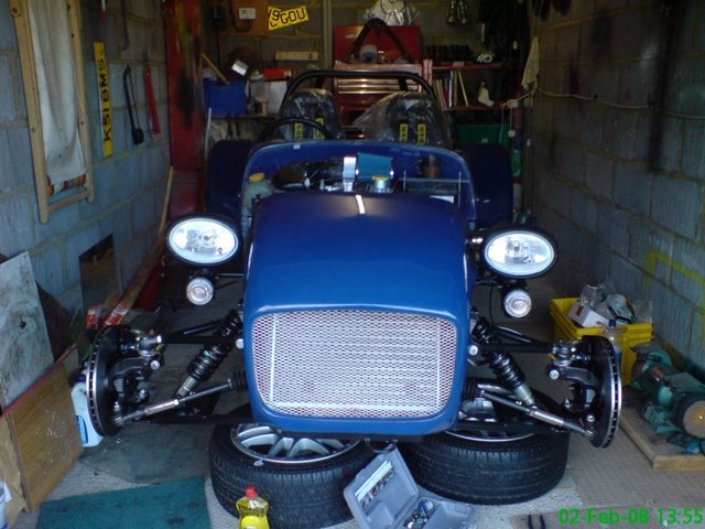

After that, i decided i wanted to fit my new headlamps. I brought a new set from MEV that they use on their Rocket. They are E marked, Hella headlamps, that take the usual H4 bulb and a side light.
Fitting was easy, take the wiring out of the old lamp unit, and put it in the new lamp unit - then bolt it on.
Works a treat and makes the car look very different - a bit wider and lower if thats possible!

nice lights, thought you should slant them up for a evil look
speedyxjs
posted on 3/2/08 at 01:27 PM Reply With Quote
I agree. Im not a big fan of the "bug eye" look of round headlights.
