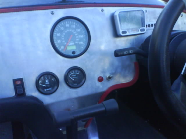

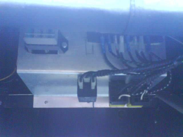

interior projections
put the relays under the dash for easy access but the dreaded head came into play again, just need to make an ally cover for them.
switches and clocks
Yes you did warn me The aeroswitch and starter button, temp gauge in exemption area
but fuel gauge and speedo not radiused, I have an ACEWELL unit on the dash behind wheel setup and calibrated purchased just for the rev counter facility, but seeing as a fuel gauge is not an sva requirement and both speedos passed those 2 offending items are going and the holes blanking off
[Edited on 14/1/09 by mad-butcher] Rescued attachment clocks and switches fail.JPG
