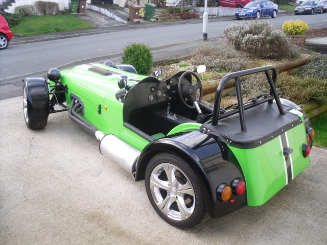

SVA on Monday
SVA is on Monday, so have been busy all week making sure that she's SVA friendly (hopefully!)...
There's a number of pics in my photo archive under 'pre-SVA' and I'll post a few below. Feel free to comment etc.

Nice
I love the colour scheme

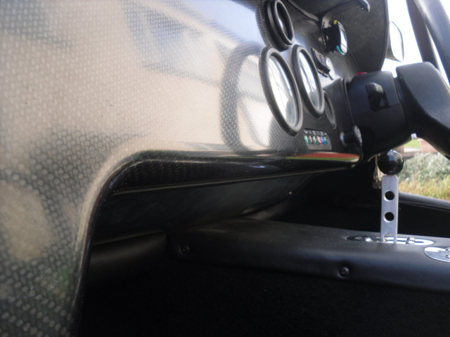

is your fog light vertical? looks slightly slanted backwards in the photo, but it might just be the camera angle
apart from that it looks spot on
what does the leaver with the red button do?

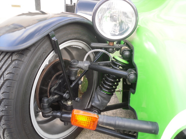

andrew.carwithen
| posted on 20/2/09 at 06:11 PM |
I've packed a piece of o-ring between foglamp lense and mount to force the lamp into a vertical position compared to the mount (hopefully!) You
can just see it in photo at top of lense. With the lense being curved, how does the tester ascertain if its perfectly vertical? or is it just a visual
check?
The red button is my ejector seat!
Naw, it's really my electric reverse.

Must admit lovely car, looks like you've covered all the bases, fog lamp concerns me though, measured mine with a set square. just one
suggestion put a nut cover on the bottom ball joint ,I think it would really finish off the front,

Mine leans back further than that my tester said nothing, just stood back at a certain distance and told me to turn the lights on, then fog light,
etc....

The shroud around your upper wishbone/ball-joint looks a bit 'temporary'. I did very similar (a piece of wheelbarrow inner tube ty-rapped)
and he asked me to remove it. The bare nut was considered to be OK.
Headlamps - he lets you tweak them so no problem.
Fog light does look a few degrees off vertical...?
