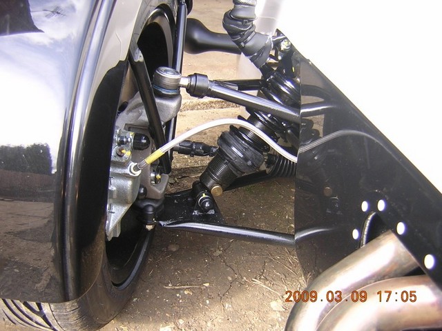

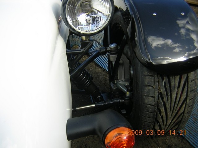

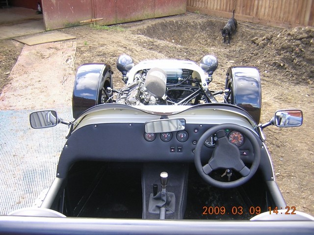

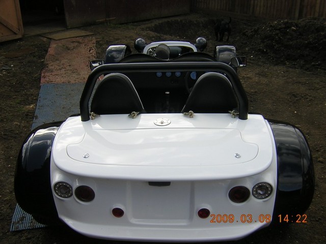

Hi Guys,a few last minute checks today before the big day,just wondered if you can spot any problem areas TIA
wayne

cloudy
| posted on 9/3/09 at 11:41 AM |
Bottom shock seats need covering, that's all I can spot maybe some issues with the headlight mounts
Looks awesome by the way - love the tyre art
[Edited on 9/3/09 by cloudy]
www.warnercars.com
02GF74
| posted on 9/3/09 at 11:46 AM |
Bloody hell - your dog's been busy!?!?!?!
- both hoses to fuel filter marked?
- think you need covering over the braided brake hoses
- indicators not too far in?
- is radius on the sterring arms where the track rods fit ok?
[Edited on 9/3/09 by 02GF74]
IDONTBELEIVEIT
| posted on 9/3/09 at 11:58 AM |
bottom shock seats?,what do you mean the bottom wishbone suspension brkt,cover with u-trim?
what do you think is up with the headlamp brkts
braided hoses have a clear plastic coating
cheers wayne

cloudy
| posted on 9/3/09 at 12:01 PM |
No the large nut that takes a C spanner to adjust the seat platform on the threaded part of the shock

Dangle_kt
| posted on 9/3/09 at 12:07 PM |
Don't the seat belt ancorage points need u trim round them? not the bolt, but the bit that snaps onto the bolts that the harness straps pass
through.
Also will the seats be considered as part of the harness system due to the belts stretching round the sides? Its hard to tell without a picture of you
in the car with the harness on. If so then the seats need harness holes in unfortunatly
Looks v tidy though.
[Edited on 9/3/09 by Dangle_kt]
IDONTBELEIVEIT
| posted on 9/3/09 at 12:12 PM |
what did you do with your shock seats james,have to look into the seat/harness issue,do you guys know how fast the tester will go to check self
centering
