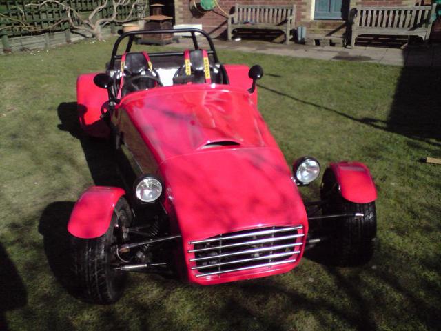

Dangle_kt
| posted on 18/3/09 at 11:44 AM |
it looks ok in his photo archive.
No screen there.
