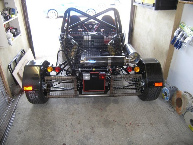

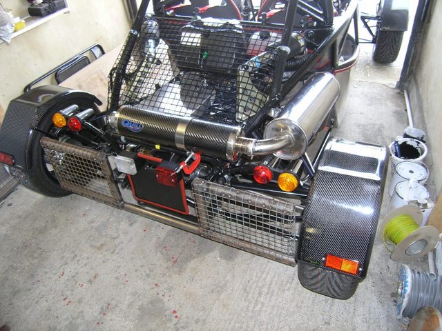

MotaLeira SVA bullc**p
This is what you have to do for open wheeled cars:
(also note the extra exhaust box which has made it louder! )

With all those safety guards fitted does it also have an emergency stop button or a dead man's handle to operate it?
smart51
posted on 23/4/09 at 02:32 PM Reply With Quote
Hmm. Is that because of radiuses or to stop people getting to those moving parts?
I take it from your style of construction that the grilles aren't to be permanent? I bet they could be made out of smaller stuff and be made to look quite nice if they were going to stay.
Why the two silencers?

How many shopping trolleys has that used then?
hee hee oh the sympathy
A farcical test ain't it...never mind so long as it passes that's all that matters
chrsgrain
posted on 23/4/09 at 02:35 PM Reply With Quote
The red 'G' clamp is my favourite bit....
Chris
Spoing! - the sound of an irony meter breaking...
tegwin
posted on 23/4/09 at 02:36 PM Reply With Quote
Thats just silly!!! Anyone who gets that close to any of the moving parts deserves to get hurt lol

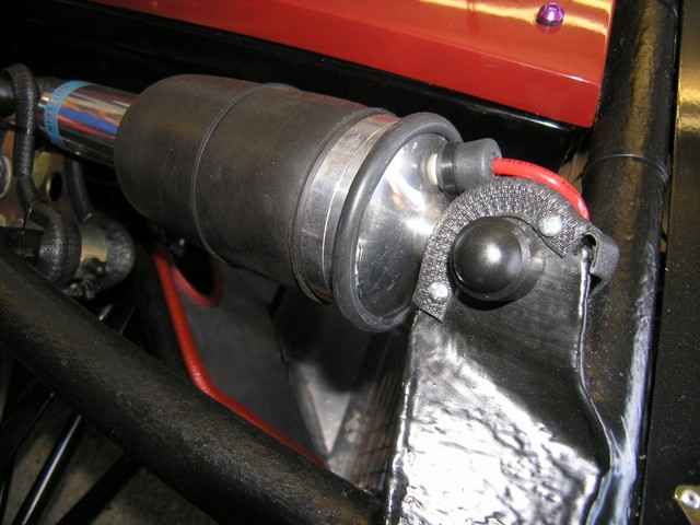

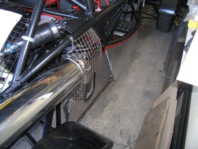

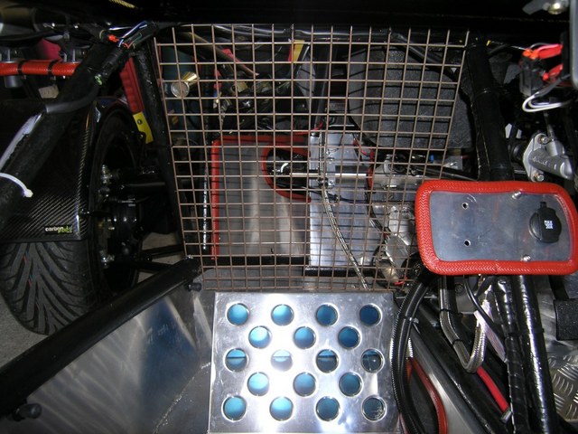

posted on 24/4/09 at 10:27 AM Reply With Quote
Here are my solutions to my failure points.
Rear projections on the brake calipers and suspension plus exhaust too loud (extra box plus fire blanket)
Moved the bodyline out (grill) making the engine and suspension projections exempt from the test
Projections in passenger footwell incuding power commander lcd unit.
Mesh plus removed PC lcd. Also removed fire extinguisher from firewall (not shown) as fail on projections (even though behind seats!
Edge on top of shock only 2mm radius not 2.5mm! Made rubber O ring and super-glued on.
Edge trim on air intake for radiator (even though it faces inwards (a ped would have to hit the edge from inside the nose cone!)
The good news is that the tester will accept a lower rev limit for the noise test if I have documentary evidence which I have got from two seperate sources.
On my rubbish sound meter it passes at the lower limit, also I have put the fireblanket on the grill to try and deflect some of the engine noise.
