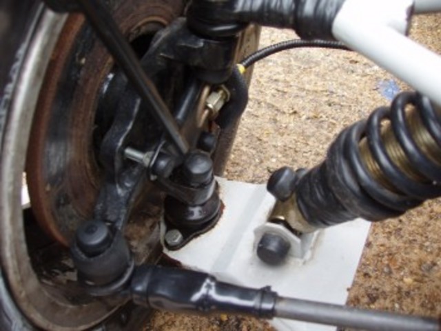

Mine passed with self amalgamating on the lower spring adjuster and top camber adjuster/lock nut, plus I made a little "wing" on the nose
cone to sheild the top mounting.
  Ft Off Side 1
  Ft Off Side 2
