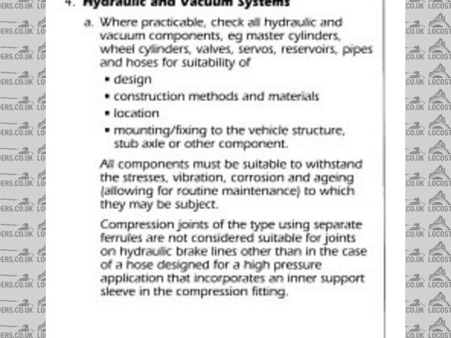

As far as I understand it, as long as the pipe has an internal supporting tube, it is a pass. The olive works as a 360 degree crimp

I haven't got the latest update of the SVA manual, but someone on here must have. I'm sure someone who has specifically said what Mark did
was writtern in there. Supporting tube = OK.

My SVA copy (latest "draft" from VOSA website) says you need an internal support tube. If the inspector gives problems, I will have a
spare fitting to show him, if there is still a problem then it looks like the hoses will come apart in front of him and be rebuilt (with new olives)
in front of him, there is NOTHING in the manual that requires TUV approved parts.

The attached is from section 16.4 para 4 in the latest issued SVA manual and supports Mark A's picture above.

| posted on 31/5/04 at 08:35 AM |
as I said, the "book" says ferrule type fittings ARE ok!! (see above)
