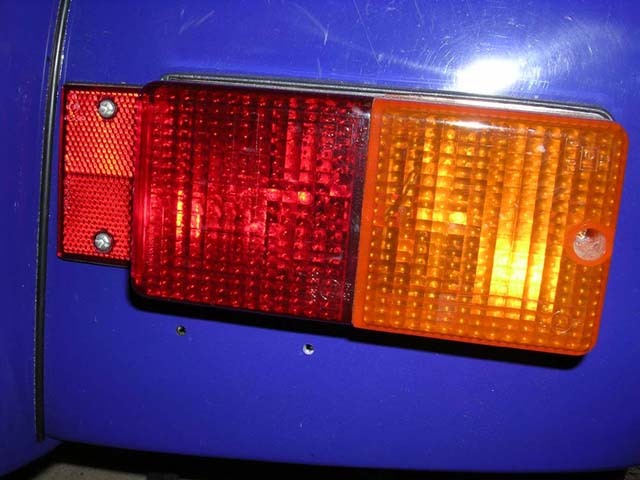

Not sure if the rules have changed since my SVA in 2004 but my rear reflectors failed on the radius edge, your look pretty much the same as mine. I
had to moove them so as the sphere couldnt make contact.
  SVA reflector moved
stevegough
| posted on 11/1/11 at 07:28 PM |
Bob is right - my reflectors were the same - even though they are round. I chamfered the edges with the dremmel. No problem on the IVA test.
