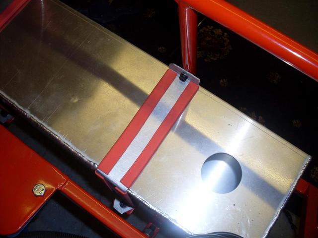

ianclark1275
| posted on 23/1/11 at 09:48 PM |
i used 2 metal straps lined with car foot mats cut up.
rivnut the chassis rail and bolt thro.
not too clear but see below.
measure twice, cut once, scrap it, start again.

quote: Originally posted by stevegough
I've got a feeling there is something that says you can't do that? I'll see if I can find it.....
No, the only reference about mounting in the manual says
"7. A Fuel Tank must not be fouled by moving parts of the vehicle, or mounted so that it is likely to be subject to abrasion by adjacent
parts."
But most people mount them as done in Ianclarke1275's photo - not with lugs.

Angel Acevedo
| posted on 24/1/11 at 03:34 AM |
Fuel Tank Straps
Using Straps is better because they spread forces during an accident over a larger area so chances of Fuel Tank Failure are diminished.
HTH.
AA
