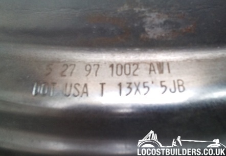

johnemms
posted on 12/8/11 at 11:35 AM Reply With Quote
I bought some steel wheels ages ago made in USA on the inner rims..
Just wondered if it would be a problem ...
Got all the right nuts etc..
[img][/img]
[img][/img]
cheers
jon

adithorp
posted on 12/8/11 at 12:07 PM Reply With Quote
Just thought of another requirement... They have to be round! Don't think that mentioned in the IVA manual though
Seriously, there's no standard requirement (like an E-mark). those should be fine.

johnemms
posted on 12/8/11 at 12:48 PM Reply With Quote
Cheers...
fitting some 185/70/13 yokohamas on tomorow then!!
