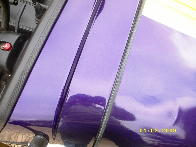

  Painted-7
Not one of your IVA photos but your car looks good in this photo
Jacko

jacko, thanks for the comments. The car is actually yellow and suzuki metallic purple, but it's really difficult to get it to show in the
picture. Looks nicer (in my opinion) in the flesh
