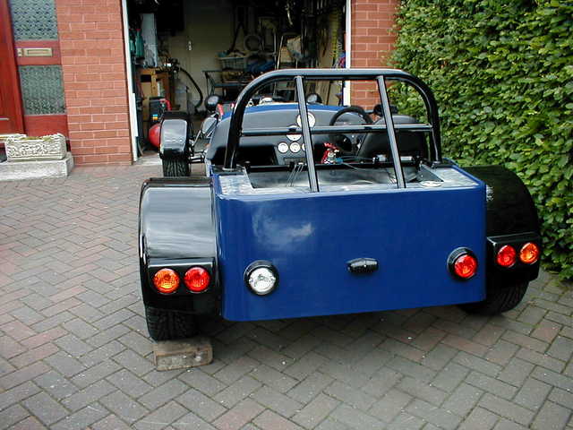

does anyone see a problem with fitting the reflectors to here? it is within the distances..

just an observation but dont reflectors have to be mounted on the rearmost surface so other motorists can see where the back of your pride and joy is
in the dark? (not based on any fact just an observation)

I don't think you'll get away with that. There's something about a 15 degree limit from the floor or something. I think the rear
panel would obscure them in that case.
IMHO I agree - besides, you know it makes sense.
Very nice looking motor Mac!!!

they look like they will be pretty well shadowed by the rear bodywork - Im wondering why you think they should go there?

If you get some rear lights with them incorporated you won't need seperate ones. Not much clearance on the rear arches I notice.

problem is there is no room due to the lights

Get a pair of the little oblong ones and stick them to the rear panel under the reverse light, then unstick them after.

what about a set of retangluar ones mounted under the rear lights on the wings

Have a look at the reflector on a mitsubishi L200, they are round with a curved base so could go on the edge of the rear tub between the fog/reversing
light and the lights on the wing.
