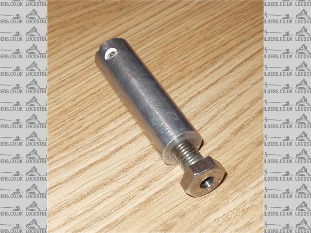

Northy
| posted on 27/9/04 at 09:08 PM |
Unfortunately they are only 70mm long. Are you sure you need them that long?
Here's a couple of pictures to show you what they are like. The indicator is a push fit into one end (wrap some tape round) and I also fitted a
little grub screw to grip it. In the other end just tap a tread, and drill the centre out of a bolt. Thread the wires through the middle.
I'm sure TPG (member on here) said he used some flat bar bent over at the ends and radiused.
Let me know if you still want them.

Northy
| posted on 27/9/04 at 09:12 PM |
And another

scoobyis2cool
| posted on 28/9/04 at 09:36 AM |
Thanks Graham those pics are great. Don't worry about sending them, unfortunately my indicators were a good 100mm inboard so I do need them
longer. I'm sure I can manage to knock something up, better get cracking!
