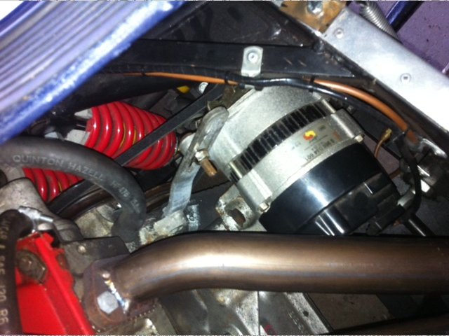

Hmm I have a picture of the alternator from when the belt went on it:
Hope that helps, and the voltage didn't change when I flicked the head lights on and everything so I was a bit clueless tbh.

Lucas ACR17 start by cleaning the blade connectors at the rear of the alternator.

| posted on 4/7/13 at 08:05 PM |
When you get it sorted it might be worth fitting a heat shield between the alternator and the exhaust manifold. Alternators don't tend to like
too much heat
