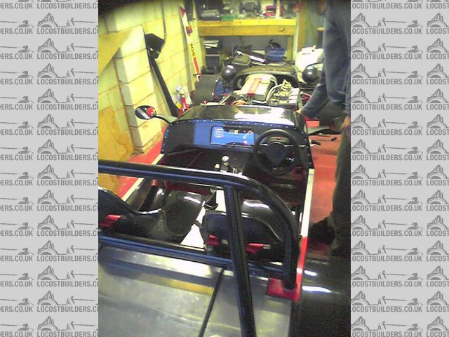

Could'nt of asked for a nicer day.... too nice infact, one of the failures was not being able to read the dash in the spring like sunshine!
(first time they had encountered it)

Mr G
| posted on 11/11/04 at 09:07 PM |
