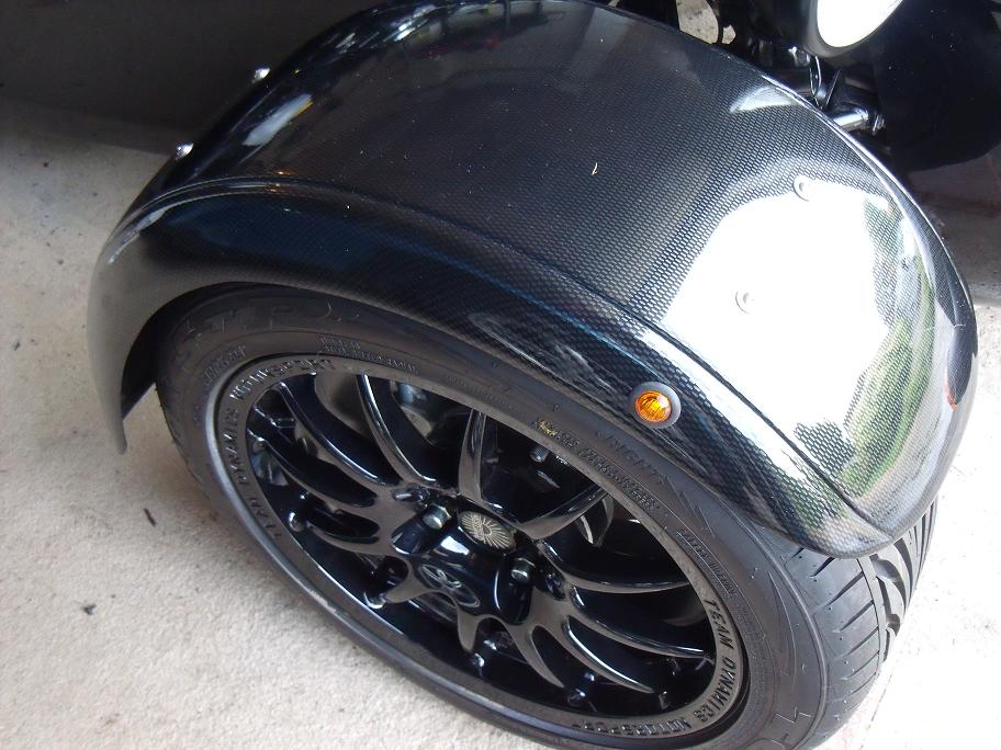

Thank you. Just to clarify how I will close the wheels, I was going to have huggers made, like you get on motorbikes, but would of course need to
cover much more of the tyre to be legal.

rcx718
| posted on 25/9/16 at 05:20 PM |
YES Exactly like that! Awesome!
I've found a company in Europe who can make the huggers for quite cheap. I am worried about how sturdy the mounts will be. Do you have a photo
of how these carbon fibre ones attach to the hubs?
