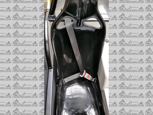

40inches
| posted on 28/3/17 at 09:43 AM |
A lap and diagonal would be far safer, easy to fit and could possibly be in tandem with the harness.
I swapped my harnesses for lap and diagonal,with the buckle inboard.

| posted on 28/3/17 at 11:27 AM |
Just one caution - that belt arrangement probably wouldn't pass IVA as the upper fixing is too close to the centreline. If you look at an
ordinary car, the upper point is high on the side pillar. In the picture above, the diagonal belt will be tight against the neck instead of across
the collarbone. It's perfect for a 4-point harness, but not for a 3-point one.
The best place to put the upper fixing is on the upright of the roll bar, on the inside (assuming the roll bar is strong enough, obviously).

| posted on 28/3/17 at 11:39 AM |
quote: Originally posted by swanny
can i ask why you swapped to those belts?
just curious, and wondered about doing similar for my kids
Getting in and out of the car was a pain, having to readjust the belts every time, not happy that pulling tight the chest straps lifted the waist
straps over my stomach. Getting a passenger fastened in Getting settled in the seat, then realizing I hadn't closed the garage door/ left my
helmet on the boot lid/left the car keys in the garage/ even gloves on the scuttle top means unfastening the harness, popping down to the shops not
worth the hassle.
I use the kit a lot more with the lap and diagonal (2000 miles in 3 months ) I still have the harness eyes in place for trackdays.
Some Caterham owners have both fitted, Caterham fit L&D belts to most of their models as standard, or did?
