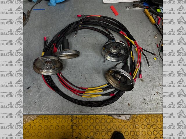

computid
posted on 26/10/25 at 06:23 PM Reply With Quote
I don't use the split stuff, I make mine using the closed expanding type. I seal the ends with heatshrink. All wires have printed heatshrink lables. It's easy to get the wires through once you get the hang of the stuff!
