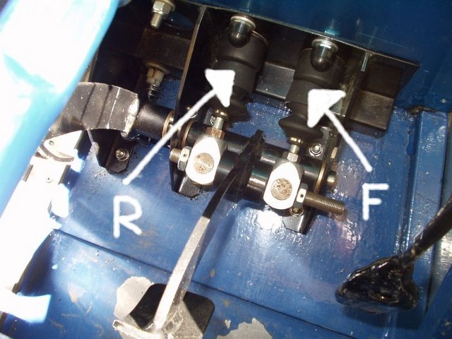

Northy
| posted on 19/4/05 at 08:26 PM |
Did you move the nuts on the bias bar Carl? You need one on each end.
Graham
carlgeldard
| posted on 19/4/05 at 08:37 PM |
Can you post a photo showing the split pin that locked it up. I was going to lock it after the test onsite.
Carl
Northy
| posted on 19/4/05 at 08:44 PM |
Yeah, remind mr tomorrow and I'll get a picture sorted for you. I drilled the nuts before SVA and just did the bar at the centre.

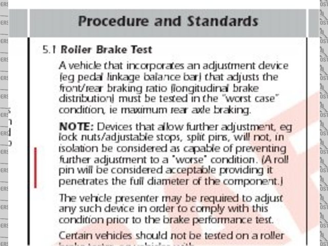

wilkingj
| posted on 20/4/05 at 05:22 PM |
Luego told me not to use a split pin, and to use a Roll Pin instead. I dont know how significant this is, but may be worth looking into before the
SVA.
I am quite happy to be wring.. just thought it worth a mention.

| posted on 20/4/05 at 05:35 PM |
Think I will take a cordless drill and a roll pin with me and fit it after the brakes are tested. I think they let you carry out small
adjustments/repairs on site
wicket
| posted on 20/4/05 at 10:26 PM |
A roll pin, see attached
Northy
| posted on 22/4/05 at 11:26 AM |
Pictures...
Graham
Northy
Another...
Graham
Northy
| posted on 22/4/05 at 11:27 AM |
Thats exactly how the SVA inspector set it to test it. This was worst case, he could not move it any further due to the bar fouling on the side of the
pedal box. So perhaps its better not to cut it down?
Graham

| posted on 22/4/05 at 11:29 AM |
Which is the front master cylinder
Carl
Northy
| posted on 22/4/05 at 11:56 AM |
No worries Carl,
Here you go!
