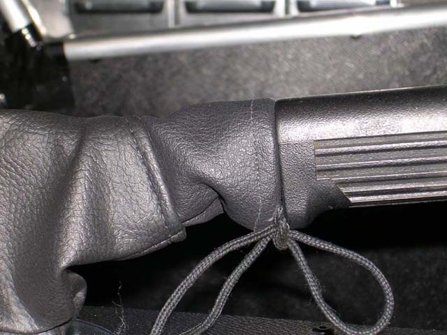

bob
| posted on 12/9/05 at 08:15 PM |
I failed on radius edge of the sierra hand grip,the gator i used tied up very close to the end but with the deadly radius gauge it was just outside
the limit (2.5mm i think) i just made up an extension to the original gator to cover.
Beware also the release button as i have heard some have failed as well,very petty in my opinion.

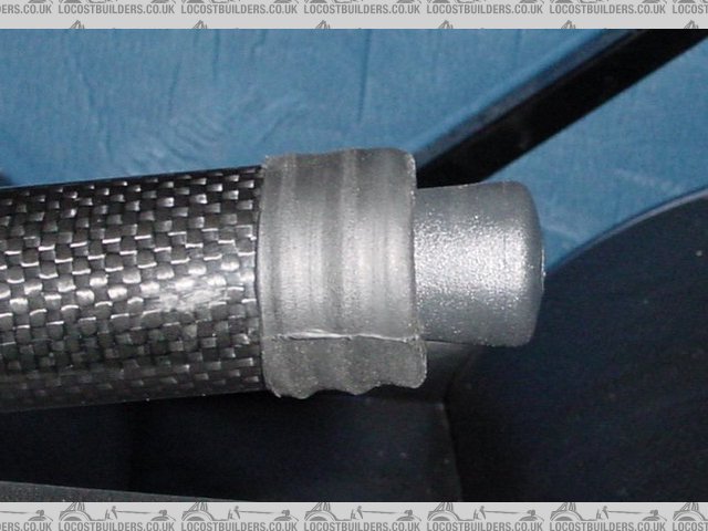

Humbug
| posted on 13/9/05 at 07:14 AM |
OK - here is the gaiter refitted. Looks good to me, though I am a bit concerned about radiuses on the end of the lever and the button (see next
post)
  Rescued attachment 2005-09-13 1 Locost handbrake lever and gaiter refitted.jpg

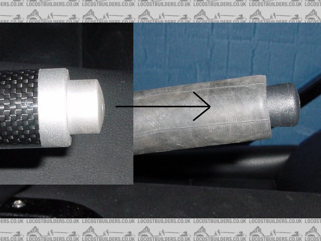

Humbug
| posted on 13/9/05 at 07:18 AM |
Here is a closeup of the end of the lever - what do you think about the radiuses?
How about the solution on the right: bike inner tube over the lever to just go up to the end of the lever and a Tifosi bolt head cover PUd onto the
original button?
  Rescued attachment 2005-09-13 3 Locost handbrake lever with shroud and different button.jpg
indykid
| posted on 13/9/05 at 09:34 AM |
that should be alright, as long as you can make it look permanent. can you superglue the inner tube to the nut cover?
i took my identical handbrake cover back because of the radius issues.
tom
coovey
| posted on 13/9/05 at 04:00 PM |
I just had a leather gaiter, but i did see the inspector grip it to see if anything stuck through. Got to be a good idea to pre empt the problem
though.
Humbug
| posted on 13/9/05 at 09:29 PM |
Now changed the inner tube for another spare bit of convoluted rubber wiring shroud (from a Metro door) - it grips the lever and hopefully it looks a
bit more "permanent"
  Rescued attachment 2005-09-13 4 Locost handbrake lever with rubber end cover.jpg
RazMan
| posted on 13/9/05 at 09:55 PM |
Nah .... I reckon that might fall off 200 yards from the SVA centre
Great mods Humbug - I will be doing something similar to my Richbrook alloy handle.
p.s. I find that a hot glue gun makes a really good 'permanent' glue - it peels away nicely without leaving a blemish on most materials
