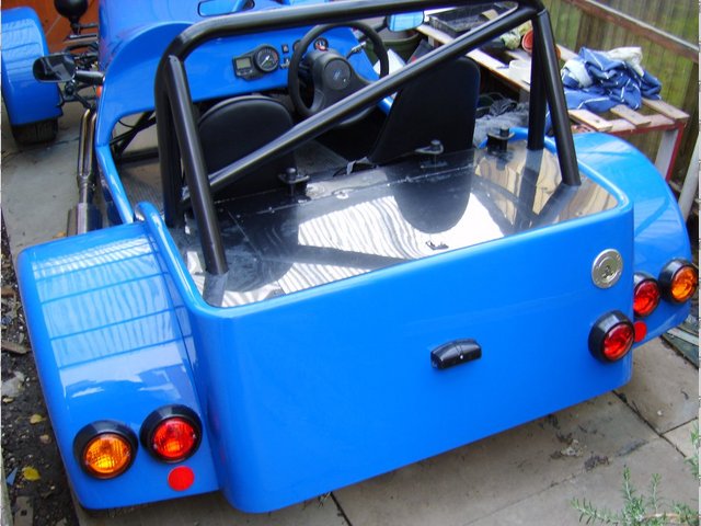

I've gone and done it. My SVA is booked for Thursday.
OK so I'm now officially worried. Please can you look at my photos to see if I've done anything obviously wrong other than not wash the car
before taking photos of it.

flak monkey
| posted on 4/11/05 at 03:29 PM |
Looks good!
You will need to cover the adjusting nut on the front suspension. Radio controlled model car tyres do the trick apparently, and they arent
expensive.

pajsh
| posted on 4/11/05 at 03:47 PM |
Radius on front of silencer looks sharp and rev counter too. Is rev counter in permissible zone around steering wheel.
Top wishbone mounts and coilovers possibly sharp too if contacted.
I used to be apathetic but now I just don't care.

DarrenW
| posted on 4/11/05 at 04:08 PM |
Track rod extension looks like it has some sharp bits. Worth covering up.
Rear lights - screw holes - are they OK? I quizzed SVA man and he advised taking along a tube of silicon just in case.
Car looks well smart. Does it self centre?
What about wiring security under bonnet etc.
Humbug
| posted on 4/11/05 at 04:12 PM |
Is the edge of the boot lock radiused to requirements?
Shock absorber adjuster knob (I used nut covers for mine)?
The mirrors look OK to me - depends if you can easily se over the rear wheel arches

Howlor
| posted on 4/11/05 at 04:38 PM |
Looks good. Just a thought as I have noticed it on mine, so you think you may need to pad the two bars in the footwells that are below the dash
line?
What did you use for your indicator extensions as they look really good?
Good luck.

JAG
| posted on 4/11/05 at 07:26 PM |
Colin, car looks great. Edges of the top wishbone mounting brackets (on the chassis) are tricky.
I wrapped thick foam around the nut covers (the cover on the wishbone bolt) and that stopped the sphere hitting the edge of the bracket. I hope you
understand. I've U2U'd you my phone number call me if you don't understand.

Marcus
| posted on 5/11/05 at 11:27 AM |
To cover chassis bracket, I riveted a strip of ally to the chassis, then bolted through bracket. Used edge trim on ally.

caber
| posted on 5/11/05 at 02:17 PM |
Rear fog light has to be vertical in relation to ground, it looks like you might need to wedge it a bit.
Caber
smart51
| posted on 5/11/05 at 05:05 PM |
thanks caber. I hadn't spotted that and you're right. Maybe I can trim the black plastic "cup" that it sits in.
