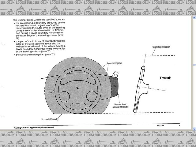

| posted on 14/11/05 at 05:03 PM |
The 'exempt areas' within the specified zone are;
1) The area having a boundary produced by the forward horizontal projection of a circle circumscribing the outer limits of the steering wheel
increased by a band, width of 127mm and having a lower boundary horizontal to the lower edge of the steering control.
In plain English: A circular area 254mm larger in diameter than your steering wheel, centred on you column, but cut off level with the bottom edge of
the steering wheel.
2) The part of the instrument panel betwen the edge of the area specified above and the nearest inner side-wall of the vehicle having a lower boundary
horizontal to the lower edge of the steering column.*
(* Should read steering wheel)
In plain English; The dash between the whele and the nearest side of the car, but not lower than the bottom of the steering wheel.
3) The windscreen side pillars.
The tunnel is a no no because the men in grey say so!
Hope this is of use to you.

| posted on 14/11/05 at 06:53 PM |
No. 127mm outside the steering wheel edge. A circle 254mm larger in diameter than the steering wheel.
The bigger the wheel you fit for SVA purposes, the bigger area on the dash you can mount toggle switches, chrome bezelled clocks and other sharp edged
devices.
Fit your 10" wheel after the SVA and m.o.t.
Sorry I cannot send the drawing from the manual. My scanner has gone tits up.
[Edited on 14/11/05 by Confused but excited.]

RichieC
| posted on 15/11/05 at 12:47 PM |
From the manual:
