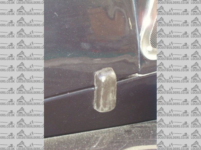

| posted on 11/1/06 at 04:35 PM |
I have built some silicon covers (see photos) and Mr SVA was happy with that.
It's the cheapest way, perhaps not the quicker, but you can avoid drillling new holes in the bonnet.

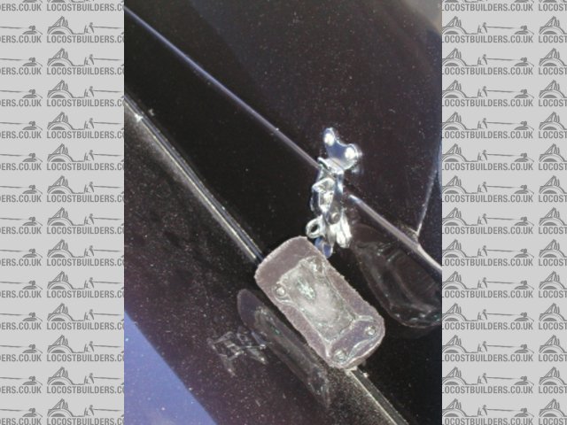

dom7
another photo

02GF74
| posted on 12/1/06 at 02:06 PM |
this is exaclty what I have in mind; covers that slip on for SVA.
please please please tell me how you make them?
dom7
| posted on 12/1/06 at 06:04 PM |
If you send me your email in U2U, I will send you some more photos and an the explanation
