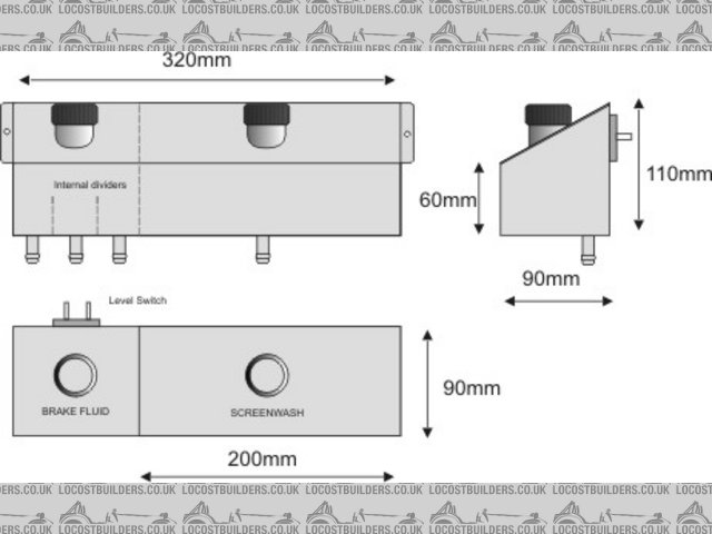

Here's what I really, really wanted to do.
Raz
RazMan
| posted on 13/1/06 at 07:43 PM |
Its basically a combined brake fluid & screenwash tank. There are internal dividers to separate the two compartments with two internal baffles for
the brake m/c's. A fluid switch need to be included somehow and I suggest it is mounted on the rear of the tank as shown. If a washer pump can
also be included that would be perfect.
.... and it wants to be SHINY!!
