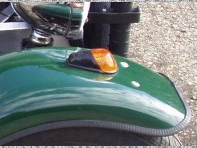

Surrey Dave
| posted on 7/4/06 at 12:45 PM |
Look!
02GF74
| posted on 7/4/06 at 01:25 PM |
quote: Originally posted by Surrey Dave
Dave, what is with the trim round the edge? obviously radiussing for SVA but manual has different requirement if wings are fibre glass than for metal
edges? (I need to look it up), don;t want to mess doign thatto mine..... grrrrr.....
and back to question; will you little row of indicators have E stamp on the lens? hmmm, wouldnlt have thought so so not legal.
Distance is 500 mm from sides of bodywork (this is the widest part that is most likely the rear wheel arches) but is 400 mm if vehicle width is less
that 1400 which it won't be; trust me, I;ve just been through all that....

Surrey Dave
| posted on 8/4/06 at 09:29 AM |
Easy to do ..............I put it on for the SVA ,but ended up keeping it on as it good protection for the fibreglass..
