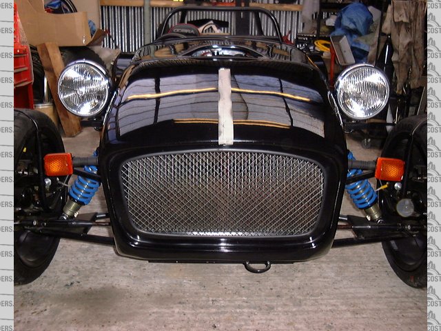

Johnmor
| posted on 23/4/06 at 06:10 PM |
SVA
Looks good. I think you may have to cover the edge of the front suspension mounting brackets, i have see people using the plastic edge trim, and maybe
the heads of the bottom ball joint mounting bolts.
Also, how have you fixed the adjustment on the brake bias bar?

| posted on 23/4/06 at 06:21 PM |
Depends which side of the bed your SVA man got out of geoff, my boot locks were like yours and they failed on radius.
Anyway the top wishbones where they c bolt onto the chassis bracket are contactable with the sphere they use on the test,i put rubber edging around
mine.
bottom shocks on the adjuster i put a gator round,should be some pics in my archive.
I used round nut covers from tifosi as i didnt think the ones you have used were any different in radius from an actual nut.

| posted on 23/4/06 at 07:08 PM |
Geoff the lower spring adjustor needs to have cover, If I get a chance will take them off of my car for you or use radio controlled car tyres

I'd be a little worried about the radius on the bottom of the dash panel - needs to be 19mm (I think).
They don't like pipe lagging anymore, unless covered with vinyl and glued on to make it permanent.

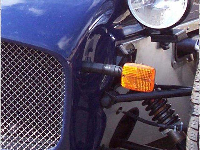

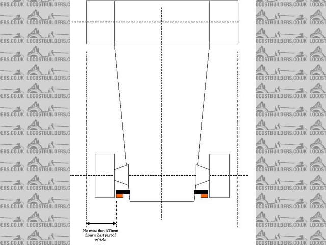

wilkingj
| posted on 24/4/06 at 10:07 PM |
Indicators
As requested... indicators I think they are OK, where is the 400mm measured from I know its the extreme outside of vehicle to where?? edge, centre,
or inner edge of the light??
  Ebay Grill
Best Regards
Geoff
http://www.v8viento.co.uk
jos
| posted on 25/4/06 at 08:06 AM |
Suspension strut top mounting could do with some cover
Leading & protruding edge of chassis member infront of top suspension pick up needs covering too IMHO
Top suspension arm pickup needs cover
Check radius of bottom of dashboard. How thick is your dash and how hard is it. If its harder than the stiffness of an eraser it will need a 19mm
radius. If its softer it only needs a 5mm radius (IIRC). Eitherway I think your examiner may view your radiussing efforts as temporary and will
probably fail you on it.
I think the collar on your steering column needs to be shoved down against the bush to stop the bush from riding up the column
Check with another builder of your car whether they used locknuts or split pins on your brake bias bar.
Donners90
| posted on 25/4/06 at 08:11 AM |
Measured to the outside edge of the indicator.
