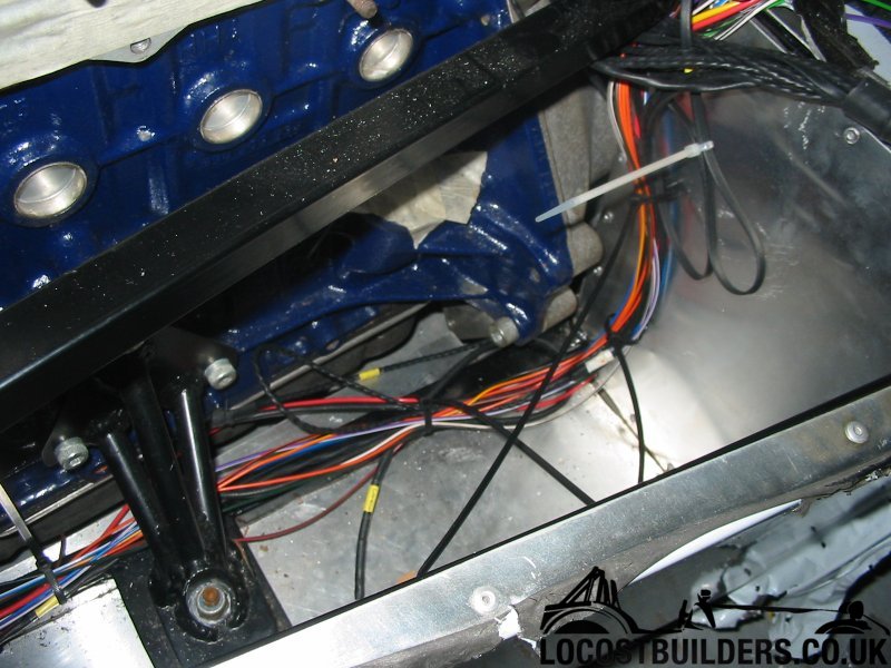

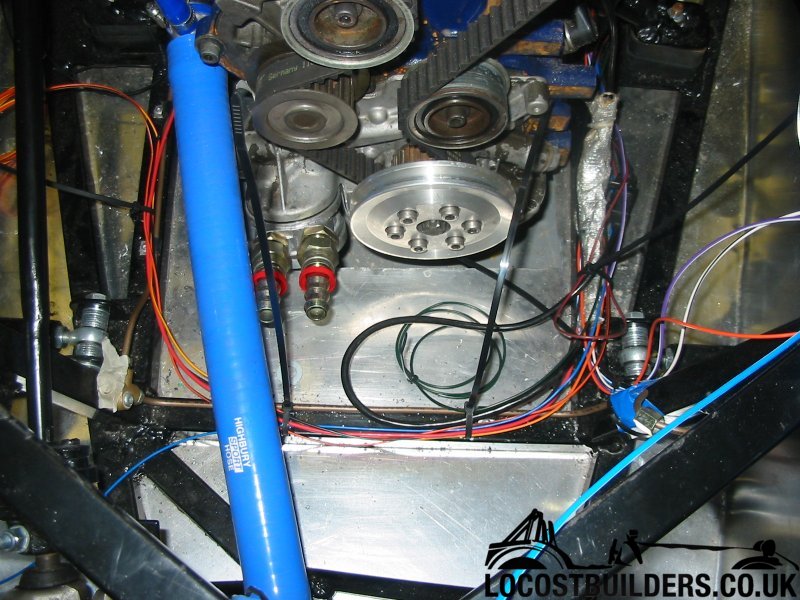

ned
| posted on 8/6/06 at 07:57 AM |
i managed to drill and rivet in some of the black plastic cable tie bases though it was a bit awkward in places..
Ned.
http://www.locostbuilders.co.uk/upload/IMG_1974b.jpg
http://www.locostbuilders.co.uk/upload/IMG_1973b.jpg
[Edited on 8/6/06 by ned]
