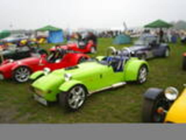

grill
as long as its not sharp to the touch,if you run your hand all over exposed bits to make sure its not sharp thats what sva man does(passed re-test
today).
