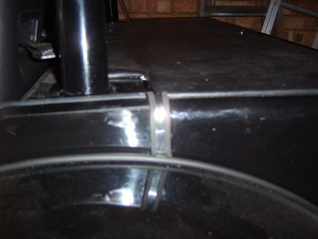

| posted on 18/8/06 at 10:10 AM |
This is what we did...

very nice hellfire!

| posted on 18/8/06 at 12:07 PM |
I used a stainless rubber covered P-clip.
Does the job for now.
For the shocks i used flexible conduit, cut it open lenth ways and wrapped twice around the adjuster, and around the small raised edge 30mm below
that. Held on with super glue. Passed fine. Sorry no pic of that.
