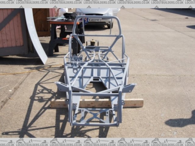

  chassis looking good

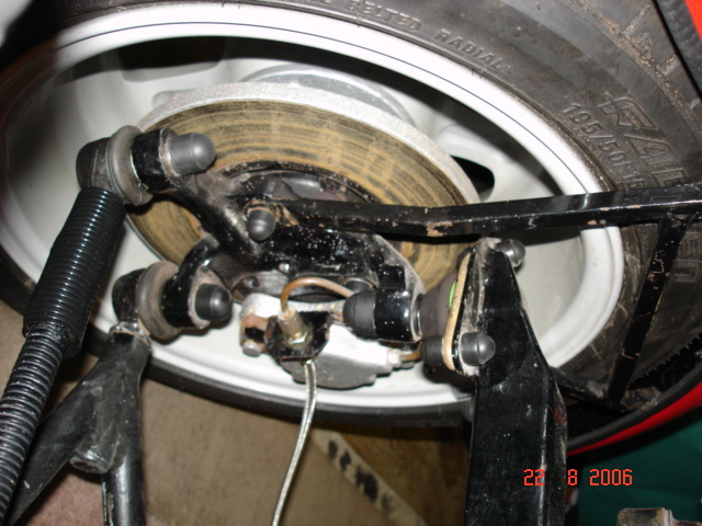

front upright - anything else you can see that is bad here? (damn, should have rotated the photo )
  front upright

One thing worth mentioning is that if your indicators are mounted on the nose cone, the suspension area apparently becomes inaccessable by Mr
SVA's test for sharp edges.
Raz
True, but only if they are quite sturdy (i.e. mounted on a steel bar). It count's as
a bumper IIRC, but SVA testers whim probably comes into it as well
