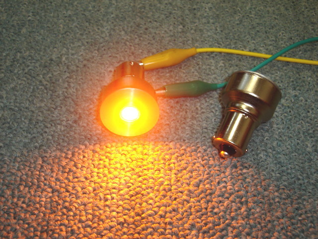

I am presently converting these lights to the new high power 'Luxeon' leds. These little beauties are rated at 3W and have a much wider
angle of view than conventional leds - I actually think they are brighter than filament bulbs but they need to be positioned further back in the
reflector to make them work well.
They run on next to no current so a good power saving for small alternators.
The pic shows an indicator 'bulb' but they are also available in red stop/tail and white versions (all 3W). The only conventional bulbs on
the car are now just the headlights.
