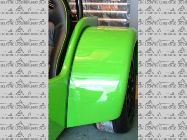

Do the back wheels/tyres need to be under the arches both vertically and horizontally from the centre of the wheel. The wheels fit vertically from the
top of the wheel to the floor, but due to the arches curving and becoming thinner the wheels stick out horizontally.

The front of the arch gets thinner.

should be fine. The same rules apply as for the front wheels IIRC. See the recent pics of the MK Sprint R for a better idea of the minimum needed.

Agreed - you have no problems there

Mine are like that and passed SVA no probs,

that's fine, mine passed like that.

Perfectly ok. The sva manual says a vertical line through the wheel centre and the wheel must be under the arch. The tyre can protrude AFAIK...it only
mentions the rim!
