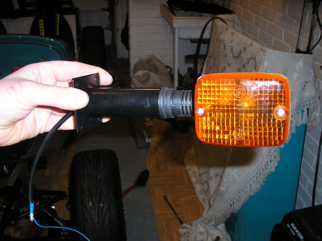

bob
| posted on 11/3/07 at 09:56 AM |
I used the regulation rear motorbike indicator and extended with plastic conduit,after the test i removed the conduit.
