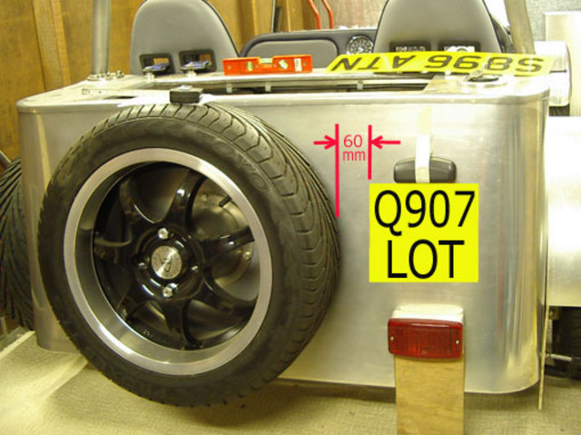

Hi All, and thanks a lot for all the replies.
Using the info from the replies I've done a P/Shop pic of what I could get away with.
With 4 letters on the top line @ 44mm this would give me a plate 228mm wide.
With the right hand side of the plate on the start of the corner rad this would leave 60mm
between the left hand side and the spare wheel. (see pic)
Does anyone see a problem with that?
Thanks again,
Paul G
