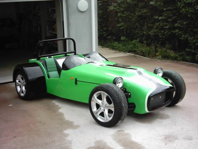

I have fitted a 'Westfield' type bubble aeroscreen (as in pic below) and am looking for a suitable tall centre mirror.
I have been considering the racetech type but understand that it is available with either flat or convex glass.
Which is better for SVA purposes and aside from the edges of mirror needing trim to give correct radius, are there any other issues I need to be aware
of with this mirror?
Andy.

graememk
| posted on 10/9/07 at 09:17 AM |
if you arnt sva'd i'd take the aero screen off
Agriv8
| posted on 10/9/07 at 09:19 AM |
Second vote for that

TimC
| posted on 10/9/07 at 09:24 AM |
Nice looking Avon!!!!

COREdevelopments
| posted on 10/9/07 at 04:28 PM |
sorry to disrupt the thread, is there any reason as to why you should leave the aeroscreen off for the sva? what would it fail on?

andrew.carwithen
| posted on 11/9/07 at 10:25 AM |
That's exactly what I have done - i.e. extended my carbon dash up to meet the profile of the aeroscreen (as in Pic below.) Therefore I cannot
remove the screen for sva. I have added trim to the sharp edge of the screen and also fitted 'tadpole' trim between the screen and scuttle
so I shouldn't have probs with regard to SVA?
Thanks for all the positive comments, guys. Must admit I'm pretty chuffed with the paint job as its my first attempt at spraying and it was done
in my garage using the 'Aldi' special offer compressor and spray gun!
Looks like I'll get the racetech mirror then. (Is it the same as the one MNR lists on its website for £15? If so, seems a good price!)
