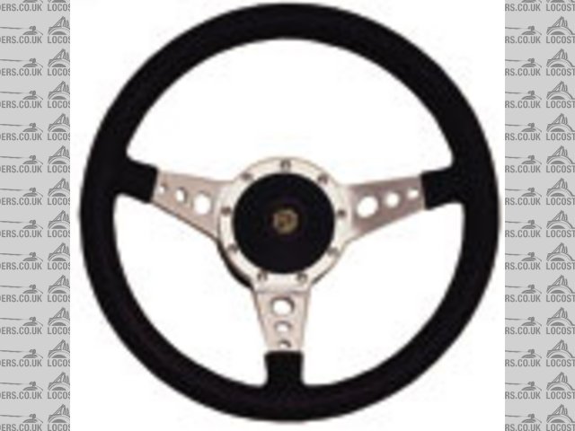

steering wheels, what am i allowed????
just curious about steering wheels,
i seem to recall i'm not allowed 'perforated spokes' , so does this meen i can not use somthing like the one in the pic below:
(to me the drillings into the spokes are perforations)
or am i
- confused and barking up the wrong tree?
- correct?
its just i have a spare one in the shed

Viper
| posted on 16/9/03 at 09:05 PM |
sorry mate thats a fail unles you cover the spokes
stephen_gusterson
| posted on 16/9/03 at 09:11 PM |
id recommend you use the donor wheel, as it complies as a tested assembly.
If you dont, you have to convince tester its sva compliant - ie, padded, not finger or jewelry traps, etc.
get the pass, then change it!
