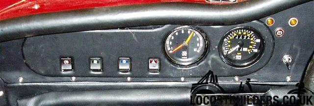

posted on 2/12/07 at 09:47 AM Reply With Quote
Hi Steve, not too many ideas forthcoming so if I may, I'll just add my thoughts.
I had the same problem because I am using old type VDO instruments with sharp edges to the bezels. I cut a surround from 6mm MDF and covered it with vinyl. This was then fitted using velcro so that it can be easily removed without any damage to the dash.
I'll try to attach a photograph.
I just wondered if you could do the same thing.
atb
