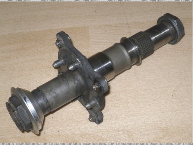

I've seen some bike wheels that I think would go well on the front-end of my trike.
Like most from a single-sided bike swingarm, they are centre-lock peg-drive, so would require an engineered solution rather than an off-the-shelf one!
Would making use of the stub-axles from the bike in question be a good starter-for-ten, or better to just scratch-engineer a pair instead?

Looking at that, you could almost see it being grafted into a Sierra front upright with the hub and bearings removed. If you can work with rear steering (i.e. rack behind the front axle line) then the same would apply to most FWD uprights as well.
Failing that, I'd imagine it would be cheaper to start with the stub axle shown and engineer a fabricated upright around it. To have something machined like that would be £££ for 2-3 pieces. Also if the upright is fabricated around it you'll get design freedom in terms of geometry; KPI etc.

For my money, that stub looks stronger than a lot of car axles so I don't think it would be a major issue.

Is the shaft hollow? You'd need some meat to machine but it looks like it would be pretty simple to machine the shaft to fit a FWD hub.
What kind of hub are you hoping to use?

Are the bike wheels from a chain drive with sprocket and cush drive ? The one you have there would work with an upright designed for it and you could fit car tyres to the rim which would work better than bike tyres. You would have a spindle which stays still more like a rear stub axle on a front wheel drive car as opposed to one which rotates like a Sierra or front wheel drive.
scootz - 16/11/11 at 09:53 AM
The stub-axle pictured is the actual one for the bike wheel that I might be using. Remember that it's peg-drive, so the stub-axle itself would have to rotate in the upright.

Is the shaft hollow? If so how much metal is there to work with for turning to fit a hub?
Davie
scootz - 16/11/11 at 10:07 AM
I don't have one to hand just now Davie. I'll do my usual and buy one... expect to see it in the For Sale section soon after we discover it's a non-starter!
daviep - 16/11/11 at 10:15 AM
Is the picture of a triumph spindle? It looks almost identical to the spindle on my Sprint ST (which is hollow).
Davie
scootz - 16/11/11 at 10:18 AM
I love this website (and especially you Davie!).
Yes, it's an ST 1050 spindle!

My bikes not here but I'll have look at it tosee how easy it would be to machine it to fit, if it's not too thin I think it will be a dooddle to make a front hub to suit. My only concern would be that it might be quite bulky as the minimum bearing size will be dictated by the size of the shaft, which is relatively large.

Its probably easier to make a stub axle to fit an existing upright (or hub for a fixed stub axle) a fairly simple turning job. The difficulty might be with offset. For that reason a custom upright might be the only way to go.

I've picked up a set of Brembo M4 Monoblocks and would like to try and use them. They normally run on bikes with 320mm discs, but I'd want to try and reduce that diameter as much as possible. I also like the 17" wheel from the back of the ST 1050 bike, so may go down that route (added bonus that it fits right onto the Triumph hub!).
