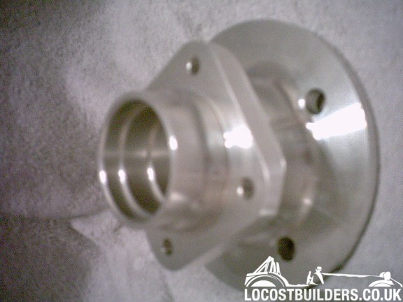

I'm thinking of getting some Alloy hubs made at the local CNC shop to 'Rally' spec and design, This should see a weight reduction of
about 1Kg per hub !! would there be any demand by other cortina upright users for this type of product ???
Jason
By 'Rally' spec i mean type of Alloy, not size of bearings used, my hubs will use std bearings so will be a straight swap
Cost is heading for under £50 per Bare Hub
Costs are £47.50(Hub)Each + £11.00(Timken Bearing)Each fitted
P&P £10 per set for mainland UK
IF PAYING BY PAYPAL PLEASE ADD 3% TO COVER THEIR HANLING CHARGES
Ally Cortina Hub pic 01

When I spoke to Icondevs about the hubs they said that because of the expansion differences between ally and steel the bearings where a very tight fit , which meant that the bearings had to be cooled and the hubs warmed in an oven to fit them easily, this was to stop the bearings being loose when the hub warmed up in normal use, will your engineers take that into account?
That sounds right, yes. The alloy will tend to get "hammered" by the bearing outer race as it rotates and then allow the outer race to
"walk" around in the hub.
So yes, the race will probably want to be a shrink fit or good press fit.
Haing said that, I havent done it so I don't know!
I think the hammering/walking action is called brinnelling, but I stand to be corrected (both technically and with my spelling!)
More importantly I'm up for a pair!
that rings as bell with the westfield hubs - because of this the bearings are a very tight fit.
That's why I'm selling them as Bare Hubs cos i don't want the oven gas bill for heating up the 50 hubs !!
1/2 an hour per pound plus another 1/2 hour should see them about done

That sounds right, yes. The alloy will tend to get "hammered" by the bearing outer race as it rotates and then allow the outer race to "walk" around in the hub.
It would be easy and cheap to get the bearing area of the hub shot peened to toughen it up if it's a worry.
It would help as certain areas of the hub (the area onto which the bearing carrier goes) would be tougher as a result of the peaning. Therefore less
prone to wear from the bearing carrier moving against it. The bearing would therefore not have to be fitted so tight in the first place- allowing
potentially for home fitment.
Anyway, maybe it wouldn't help but an interesting idea nonetheless!

The whole point is that the bearing should be a good fit and never move around in the first place afaik
Ned.
I know shot peaning is used to reduce stress raisers but to toughen alloy surfaces, that's a new one on me.
I'm pretty sure it's used in Formula 1 to surface toughen gears.
James
I can tell you from experiance that a lose bearing shell rapidly wears away even cast iron. Not a pritty sight to sort out.
As for the shot peening, are you talking about 'work hardening'?
I know that work hardening increases strength (not 100% sure though, may be wrong if so please correct me) but not sure that it affects wear rates.
As I said, it probably wouldn't work. In fact maybe it's not even used on alloy. Formula 1 gears are of course a tough alloy steel in the
first place. But they are peened to give the first 1or2mm of surface a tougher finish.

It's nothing to worry about, no need for peening etc, as long as the fit is tighter than that used on a steel housing, that's all, lets not get carried away. Other thing (expecially on a low mileage car like this) is to also loctite the outer races before pressing them in.
