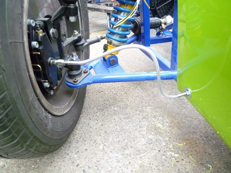

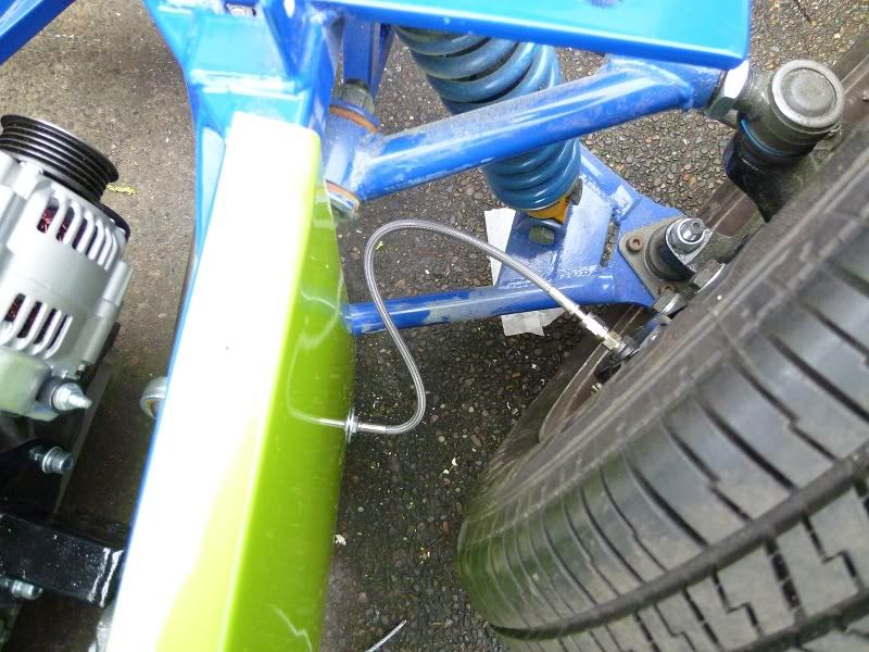

Do you think my flexi's are too long??
[img] [/img]
[img] [/img]

Look ok to me

What are they like on full droop and full lock ?

looks fine to me
Both photos are full lock.
I thought a bit too long, but from the feedback I think I'll leave them!
Thanks all.

nothing wrong with them, as long as they don't rub on the wheel or wishbone
